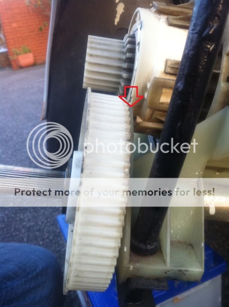

Dont know if thats the tech term for it  ???, its where the arrow is pointing, as much of the edge of the gearbox as possible needs to be resting on there, the cable tie will pull that under the gear box when pulled tight. and stop it slipping off.
Hope this makes sense...

« Reply #11 on: 12, August, 2011 - 20:00:57 »
Thanks... I just fitted the cable tie, it has helped, but I am still having to pedal up to a fair speed downhill to stop the drive belt slipping  ???    >:(
