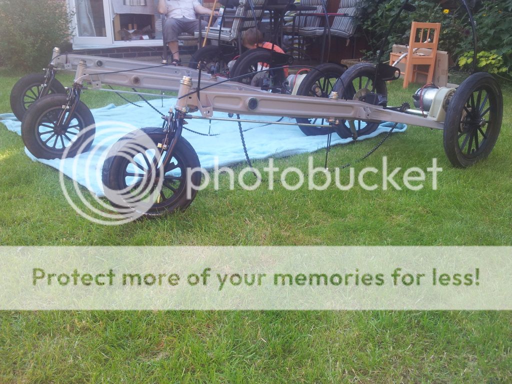

Hi all - makeing the most of the weather I moved out of the workshop and into the garden to turn my attention to 3 c5's in for repair
The wiring looks very challenging and there are a number of issues for the top bodging gallery (not by the present owner) so I will post them later but in the mean time some progress ::

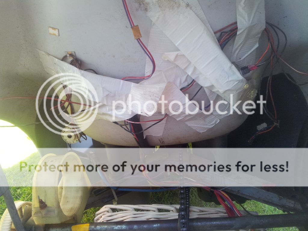

As received - although working two of them were a wiring nightmare :
A very large on - off switch
So decided to strip all 3 and start again - so far the motors have been rebuilt - one replacement gearbox - all new inners - one set of tyres - 2 control box repairs - one replacement control box - all bearings greased or replaced - metal work painted - new brake blocks and cables
Next to get the bodies back on with power wiring kits and new harness as required :
Marty

« Reply #1 on: 24, July, 2012 - 20:27:11 »
Looking good keep the photo's coming .....Chas
Re: 3 off repairs for John
« Reply #2 on: 25, July, 2012 - 11:19:46 »
That will keep you amused for a few hours or so  8)

A bit more progress today - major head scratching on wiring but managed to get back to original :
From this :
To this :
And the none indicator version :
And found some little visitors:
Now for some of the bodges :
Wiring harness with quick release clamps :
Large on off switch :
The old belt slip fence mod :
And a good one that seems to work well :
Marty

Did the C5's actually work with all that bodging ... i would have thought the risk of something going bang was probably quite high  :o ;D
Looks like you've done a great job on sorting them all out .. well done  :)
  • Administrator
Re: 3 off repairs for Johnny5
« Reply #8 on: 31, July, 2012 - 20:53:00 »
Cheers Minidaz - yes believe it not two of them worked to a fashion
