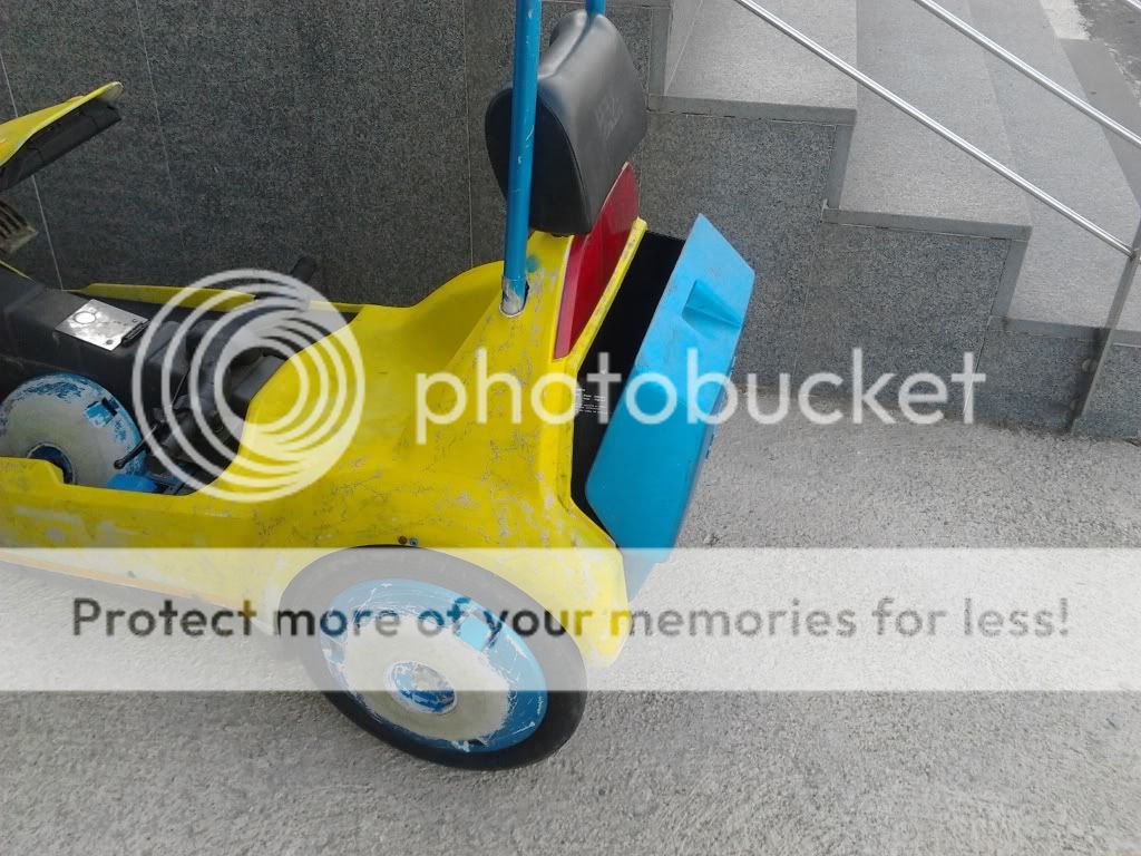

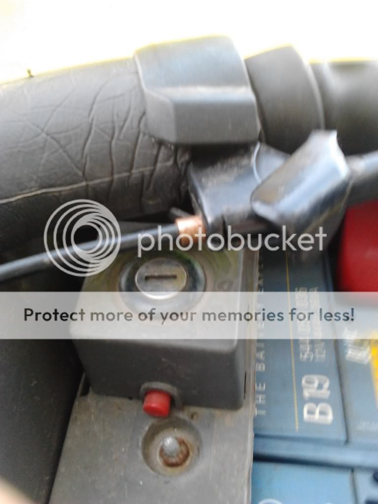

Here I put you photos form the stat when I have got the C5.
In this moment the C5 don’t work, after loading batteries (there was very empty)  I have made the test to put the 12V directly and the motor goes, but over the normal way with the micro  switches not, so I will dismount the cassis to clean them and to look up to the connections and cables.
Like you can see this C5 is not normal, original they have made changes while this one was driven in the city in Berlin.

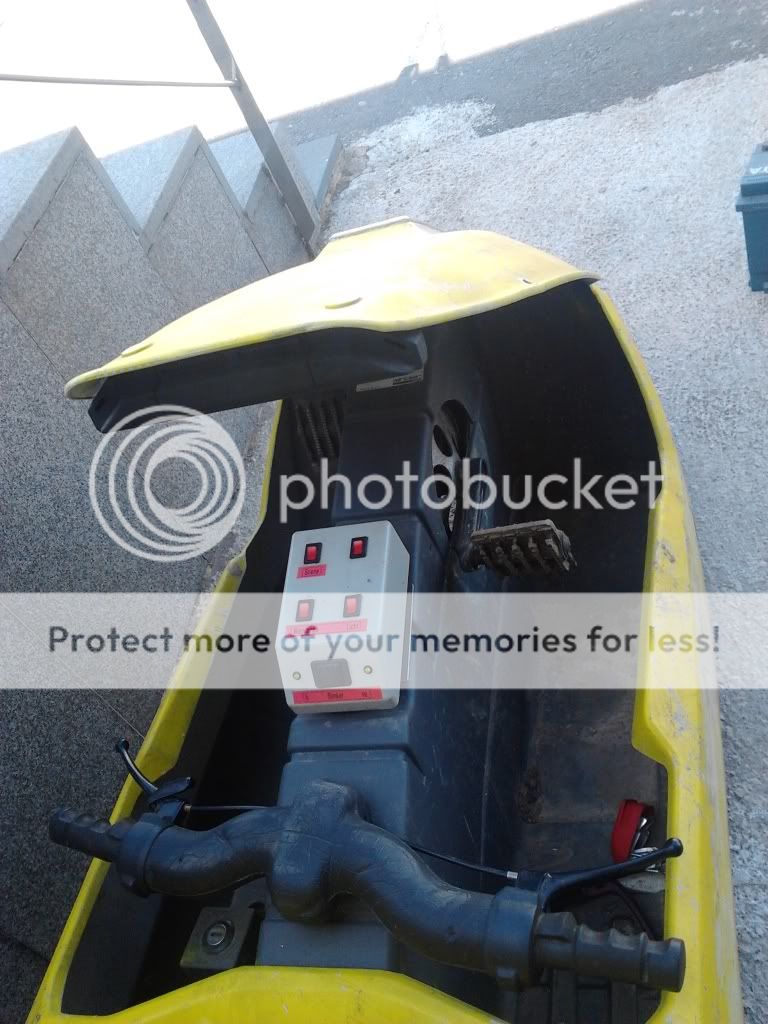

After charging the battery yes the POD have lights (all on) and my external lights are going.
I have through that the battery don’t can give enough Power for the motor but for the system that need less power yes its enough.
BUT putting the same battery directly to the motor minus and plus the Motor yes "works".
So I think it must be the fold in the circuit of the Power-Motor control, I don’t know if in the cables or in the Control-box, the 2 fuse in the Box a right (0,2 OHM).
So before i will look each cable i thought maybe there are a typical "folds", also maybe there are the Temperature sensor broken?
Best regards an thank you very much for your help and if you need Photo i can make them.

That Pod isnt happy...the left hand set of lights shouldn't all light up like that . The right hand side of the display is like a fuel gauge to show how much battery power is available, and the left hand side of the display is a load meter to show how much strain you're placing on the motor. It should show a sequence of red, amber, green lights according to how hard you're working the motor.

« Reply #8 on: 14, March, 2012 - 21:11:36 »
Yup, that POD doesn't look right, it should look like in the photo below;
and function like in this video;
Edited to add better picture of POD

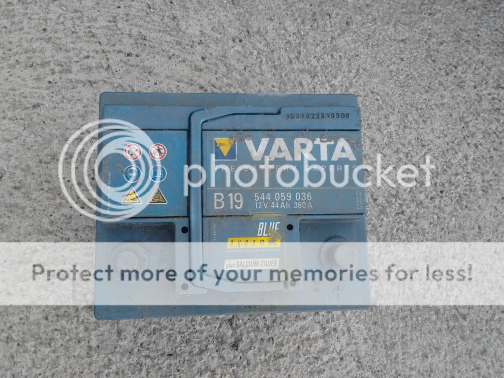

So now I have made the test with my car-battery off (50Ah and 500A max load) the battery don’t was very full and is 4 years old but with the voltage off 12,4V it was possible to go up to 20km/h and the voltage doesn’t drop down to less than 10,8V, with the battery’s that’s comes to me the voltage goes down to 9V.
So it seems that I need a new battery, are there a special type or model that you have good experience with.
I saw that the battery of about 40-50 Ah have a good pieces.
Best regards.
Thorsten
Re: 2(4) C5 in Spain
« Reply #12 on: 26, March, 2012 - 08:52:44 »
Hi there Most of us use a Leisure Battery of about 75/85 amp hour . Unless you are using the original key switch. bye Chas
