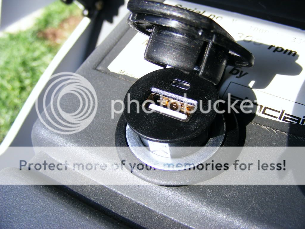

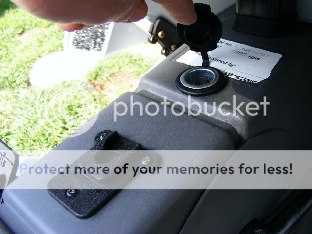

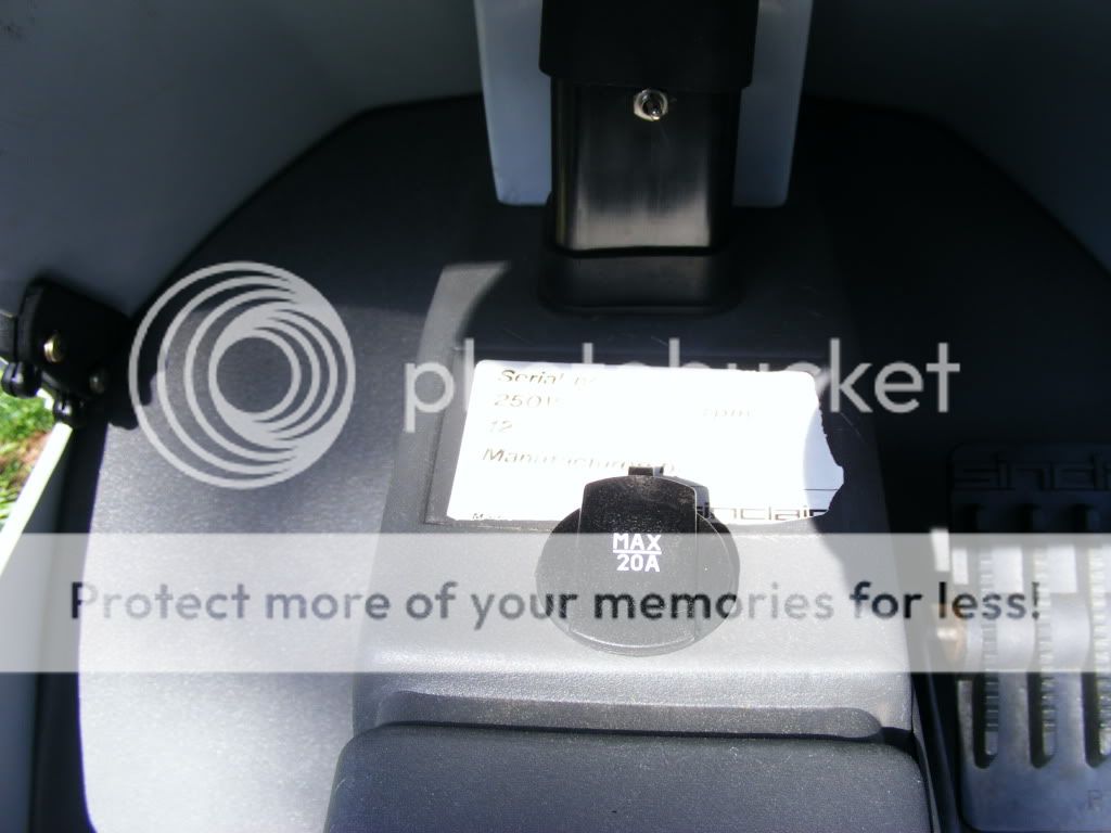

I have added a 12volts cigar socket to mine.
I drilled a whole and fitted it.
