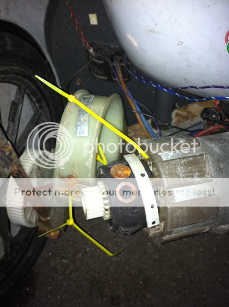

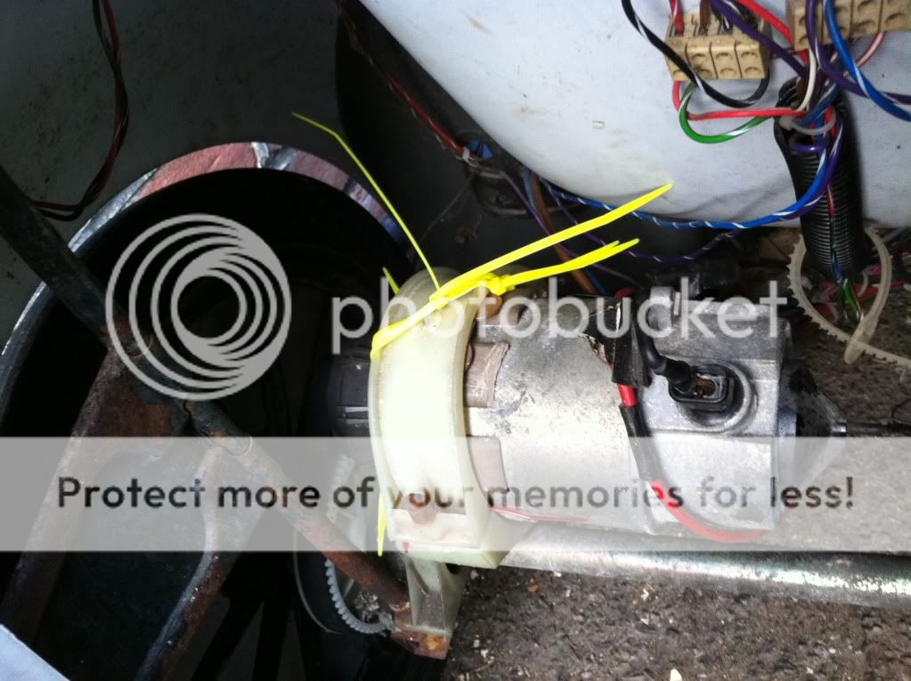

One interesting bit of damage is that the brown gearbox wobbles when tested, had a look a moment ago and removed the motor. The motor was cable tied and mounted with additional ali plates and 1p coins to give the correct tightness/belt tension!!   Basically all the legs/pins that secure the gearbox to the motor are not there!, guess someone tried to replace or regrease something maybe, or there fragile and just broke.
Either way, I will need a new motor/leg part.! I'll also fix the pod and either remove/blank or leave the switches is, i want it operating correctly, but i might just leave the switches as i think it adds a story and is probably better than using grommets..

Thats those "brown fingers" as featured on the linked topic below;
http://c5alive.co.uk/forum/index.php?topic=322.0
...very brittle plastic that just tended to shear off rather than flex - as demonstrated in your piccies.
Top bodging to get round the problem  ;D
Assuming the greabox and motor are sound just replace those fingers with a cream coloured set  ;)
