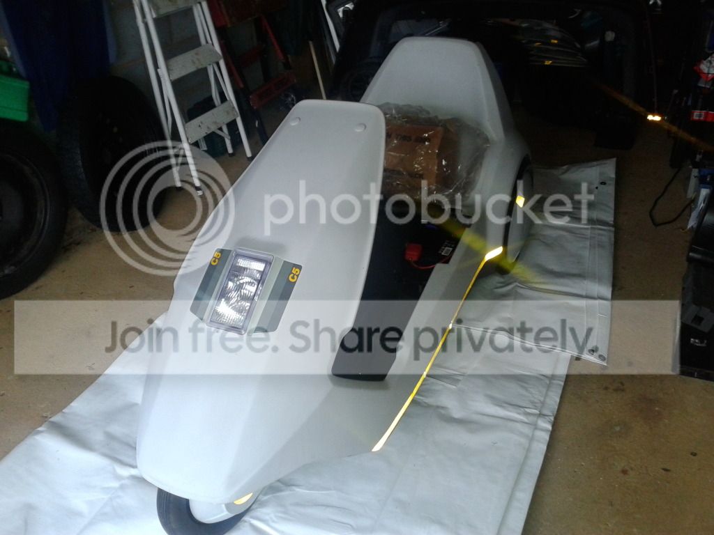

Had a C5 in for a wiring kit conversion and an issue with the motor due to never having been used - The C5 was a display feature in a motor show room and was virtually mint - The owner was selling in and tried powering it up but no luck - After a motor strip down and fitting the kit the  C5 sprung into life but found it had a permenant red motor load due to a duff ULA chip - just goes to show we desperately need a replacement for this chip as even unused once can go down  :(

there's a very good optical illusion in the second photo, when I first looked at it I had the impression that you had a pickup bed on the rear.
