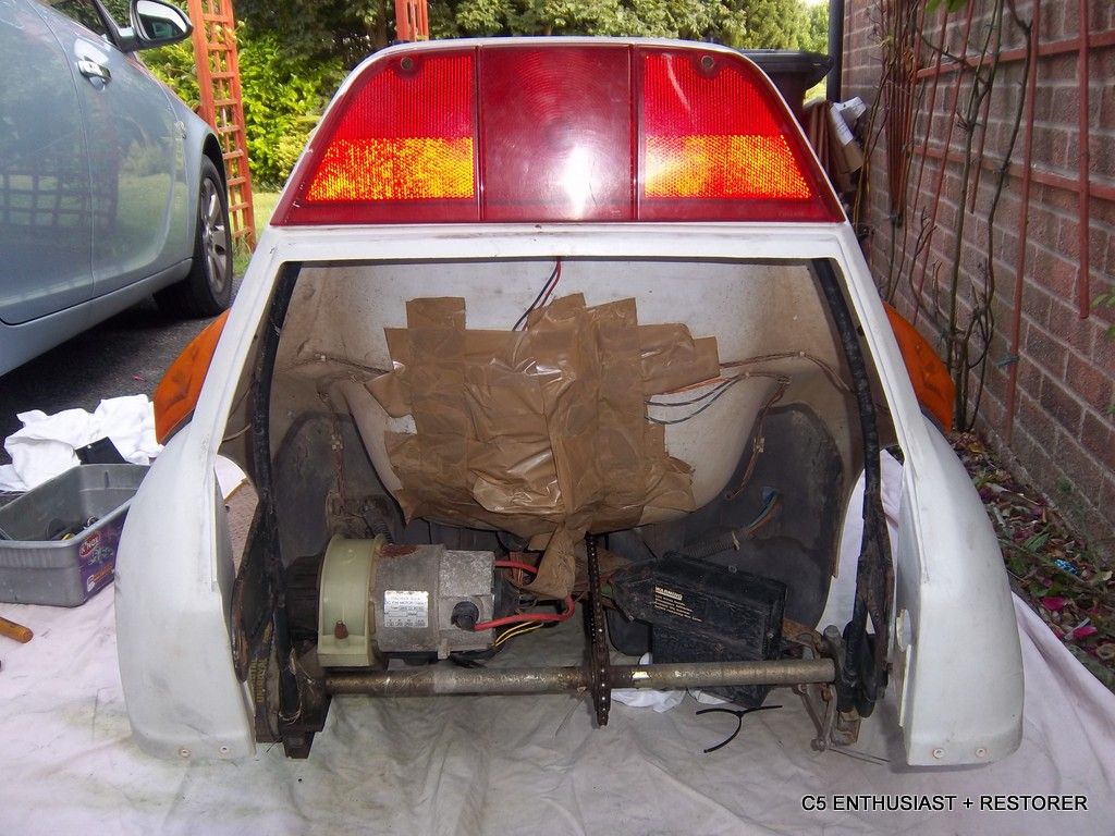

Hi all here is the latest  restoration That I will be doing for Mark ..
Ok that's the stripdown completed now the clean up / rebuild ...

someone was a big fan of parcel tape  ;D
Re: Latest restoration for Mark
« Reply #4 on: 29, July, 2013 - 14:17:13 »
Yes you right .It was only there to hold the wiring in place ..I may do the same .....????????????????? :) ;) :D

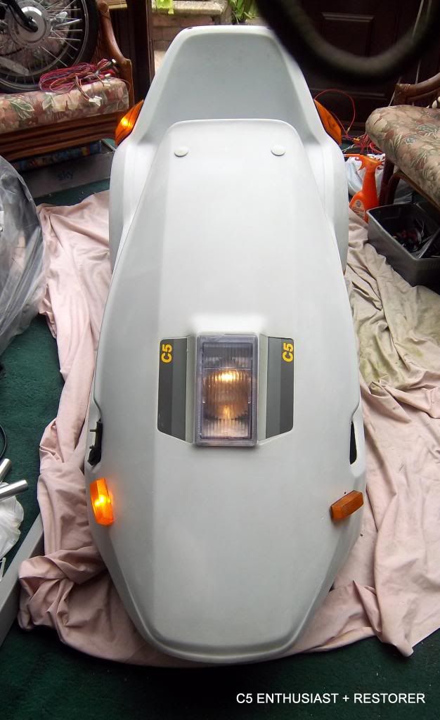

Hi all just had a go at cleaning the Body and it's looking great take a look at it now. (No sticky tape in site ) Will be checking the wiring in the morning ...Before building lt up ....

Just got to admire your work  ;)

Hi Chas,
The body looks great, what do you use to get it looking that good other than elbow grease? I've been restoring my C5 but I have been putting off the job of body cleaning! Should I leave the wiring loom on or take it off?
« Reply #10 on: 15, August, 2013 - 08:11:15 »
Hi there Paul regarding the wiring loom I always leave it in place unless the body is going to be left outside in the rain .. Also it is always best to check out the wiring before rebuilding as I will be doing today ..If you don't you may find that there could be a break in the wiring loom and it is very hard to to find and repair it after the chassis has been fitted ...The cleaning elbow grease is the best with Cif cream...
